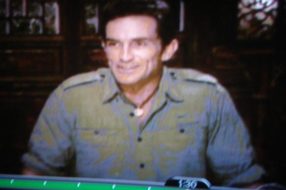

I have been reading these posts & believe I am having a similar problem. I have a 6-year old Sony KP-51WS500 wide screen projector that up until a few weeks ago, always performed flawlessly.
A few weeks ago, my TV developed a red shadow in the top left & bottom right corners. These shadows were in a spiral pattern, rotating in a clockwise direction, getting better as you looked more toward the center of the screen. The picture at the center of the screen is pretty much perfect. A day or two after the initial problem, the problem cleared up on its own.
Two days ago, the problem returned & seems to be persisting.
I've talked to a local repair shop regarding having them repair the TV. They tell me that for them to repair it could cost anywhere from $250 to over $1,000, which leaves me in a quandry as to whether to have them repair it.
I've never done TV repair, but I am handy with a soldering iron, can follow directions and am very good mechanically. My questions are three:
Could this just be a convergence adjustment that the service manual would help me perform?
If repairs need to be made, is this something I can handle with a little guidance from this Forum and/or the Serive Manual?
Should I just scrap this TV & buy a newer model?
Please respond either via the forum or directly to my email: [email protected]
