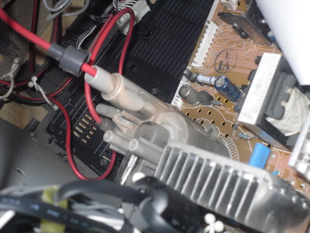

grathan
Hello, I am looking to
Hello, I am looking to replace the convergence ic chips. I have the board mostly removed except for two red wires hooked to something. Any thoughts on how to go about getting detached here?
IWhat is this?

grathan said: Hello, I am
grathan said: Hello, I am looking to replace the convergence ic chips. I have the board mostly removed except for two red wires hooked to something. Any thoughts on how to go about getting detached here?
Questions before yours related to "Faint Hor Lines" in dark background.  If you have this symptom, check out the Convergence Gallery to confirm if it is a convergence fault and not a CRT-related problem.  Sony 46WT510 convergence fault is #8 in the Convergence Gallery. Convergence symptoms are colored outlines and a 3d picture.
Do Not Disconnect the HV Wires (thick-red).   Unplug the other plugs from sockets (marking where they came from). Loosen the plastic Tie-downs that hold the Large Red wires in place to allow the printed circuit board to be twisted out and worked on whille still attached.
You can turn the board over and solder while the HV leads are connected.  If you dis-connect the HV leads, there is very good chance the connectors will be damaged or you will not be able to re-connect correctly.
Many DIY attempts at this repair end up with a junked TV because of User Induced Faults or poor quality ICs from Internet shopping carts.
