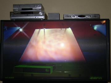

When watching ESPN, you say the bar is only on the right side of the screen? Can you take a screen shot and post it to this thread using the "Add Images" link directly above the text box? I'll compare that to what my display looks at when tuned to ESPN, and we'll go from there.
Good to see someone else thought the Sharp was a good choice! I am attaching a few screen shots.
Screen 1---ESPN (Top right gets cut off)
Screen 2---ESPN (Top right gets cut off) another image

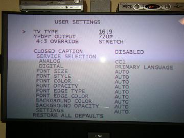

Screen 3---This is the setting I have on my COMCAST HD Box.

Great shots. I think your problem is that the TV can display HD signals in one of two display modes. Right now, it looks like it's being stretched twice: once by the cable box, and again by the TV. Click the "VIEW MODE" button on the remote, and that should fix you up.
However, there are few easy things you can do to drastically enhance your performance. Change the setting in your cable box for the YPbPr output to 1080i instead of 720p. Though the Sharp is 720p compatible, it is not a 720p native display. This means the TV downconverts to a lower format for display (and not well either). The Sharp is 480p/1080i native, so you haven't yet seen how good this TV can look. ;-)
Second, change the 4:3 override to 480i or 480p. This will allow you to use the TVs "VIEW MODE" button to control how the image is stretched to fill the screen. Smart Stretch is the obvious choice, which will work with either 480i or 480p material. Try both, and see which display format looks best.
Try that and post back fellow Sharp owner.
Thanks for the help, the set looks great. Just in time for the Super Bowl! Very helpful post.
