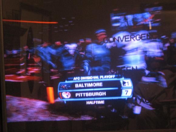

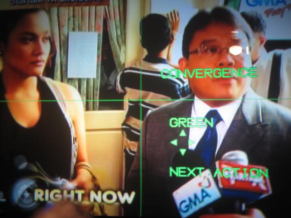

Hello all, I recently stared having problems losing the color green did some searching and found that I needed to change the conv. chips. Bought a kit from tvrepairkit.com and got to work. Initially I removed the incorrect resistors but replaced them afterwards. Tv powers up and works great for about 15-20 minutes then the green goes away same problem. Turn off the tv and back on after 2-3 minutes same thing. Any ideas and suggestions would be great.

Sounds like the power to the tube not the convergence,if it were convergence the green would still be there it would just be off centered or bowtied.Check for voltage to the green board.Or it may be a bad green tube.

I hope that's not the case that would mean I changed out good conversion chips =(. I was thinking that as well but all three tubes still illuminate? But I made a discovery last night. One of the resistors marked on the board for conv is burned. I'll upload a photo of it later. the color code on the resistor is red, blue, grey, gold.

Replaced the resistors, same
Replaced the resistors, same problem. So weird because all three tubes stay lit...

To me it looks like you are
To me it looks like you are looking power to that tube. It does not seem to be illuminated when it does it.
