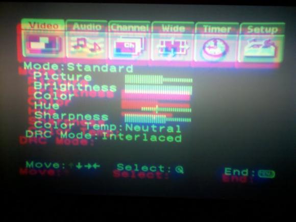

i replaced both stk chips and checked all 6 pico on the d board and the 2 on the g board and still no change i got the tv for free off craigslist any ideas

the red shadows everything it seems dark picture as well
Can you put a picture on here so i can see what you mean? Did you manually converge the colors after you replaced the stk chips?

when im at convergence there is lines that dont match up what should i do there ill post a pic

why are the lines at the right of the screen curvy like that

and why are the lines curvy on the left side of the screen
