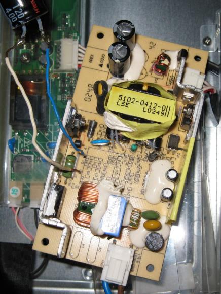

I have a gateway LCDFPD1730 that makes a hiss or Hum when it is turned off. I removed the back and I am trying to tell where the noise is coming from. I used a mic connected to the computer and the noise seems to be coming from the largest black cap on the middle of the board. Should i try checking or changing the cap first.Gateway power bd FPD1730

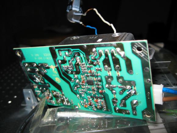

yes it does stop as soon as
yes it does stop as soon as AC power is removed. I removed the large cap the capacetance measures ok soe I extended the leads to isolate the sound. When I plugged in the power the cap is not the noise it seems to be undeneath it. Here is a pic from the back side of the bd. there are some components on the back too. The 8 pin IC in the middle looks like a 200d6http://www.alldatasheet.com/datasheet-pdf/pdf/115079/ONSEMI/NCP1200D60R2...

noise still seems louder on
noise still seems louder on front side. Pic closer to the front with cap removed

After looking a little closer
After looking a little closer it appears this board only provides 2 wires for an output so I believe it is only a power supply. I know it was a bit of a risk but I plugged it in with no load connected and it still makes the humming noise so it appears it is have issues when there is no drain on it. Also with no output it did continue to buzz for 10 seconds after removing power.
