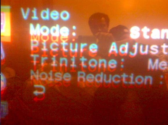

I have a 43" Sony Model #: KP-43T75.
There seems to be a problem

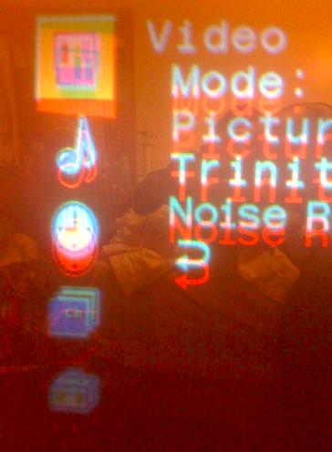

with the TV. I have tried to attach the photos. Please help. The red
ghost image is under most of the writing.And it gets worse towards the
left and towards the way end of the right, it seems sorta fine.
I went ahead and did some stuff from the service manual, and the
convergence is perfect in the top right hand corner, the red is off
everywhere else though.

nuts man
yea you need to buy 3 things
yea you need to buy 3 things one is there are 2 big ic chips that are mounted on heat senks thay are black and say stk392-150 there are 2 you need to replace both and there are little yellow fuses in front and beside the heat sink that need to be checked and the bad ones need to be replaced.
