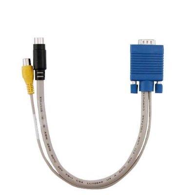

I have an Acer Aspire 1350 laptop that runs Windows XP. My laptop has a VGA output and a S-video 7 pin output as well. I have a Sony CRT tv, with a 4 pin S-video and a RCA composite like most CRT tvs. So basically, i bought a VGA to S-video (female) and RCA (yellow composite - female) Y cable, thinking to connect the VGA to my laptop and the RCA to my TV. I bought a phono cable to connect the RCA to my tv. Herein lies the problem, when all the cables are connected, i can hear the sounds but there's nothing on my tv. I have tried pressing Fn+F3-8 and nothing seems to work. All that did was make my laptop screen go blank for a couple of seconds and then my laptop screen comes back.
I tried going to Display>Advanced settings to lower the resolution and it doesn't seem to work. Please help!!! I am at my wits end and have no idea what to do. I am beginning to think that i bought the wrong cables and that this is NEVER going to work. Any suggestions and help would be greatly appreciated.

The item you have looks like this:
This is pretty much the same thing as the "vga to component" video cables they sell, only this one has an S-vid and composite cable instead. I talk about it here: http://www.techlore.com/article/10061/How-To-Connect-a-Computer-To-Your-...
Ths use case for this kind of cable is, particularly with an S-vid and composite attatched, is a rarity. It would connect a composite or S-video device to a monitor/display that supports these signals through a DB-15 input.
In some extremely rare cases, a computer graphics card "may" have the ability to output these signals through the DB-15 port, but I know of no such card that actually does.
According to what you've said, your laptop has an S-video output. All you need to do is connect an S-video cable from that port to your TV. Press Fn+F5 until the image appears on your TV (or you may need to go to your advanced display settings).
Now, I've only seen reference of this laptop in the UK. It may output in PAL by default, it might be NTSC. Something to keep in mind depending on the kind of display you're connecting it to.
