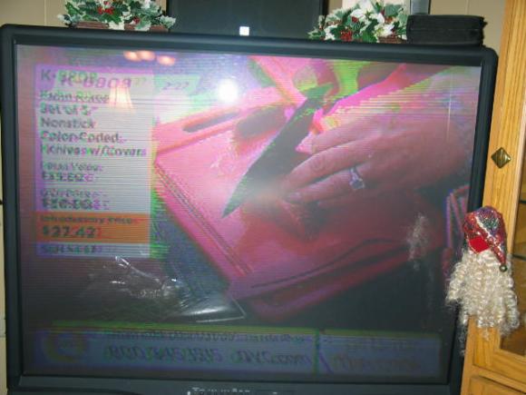

Not sure how to describe the problem with my Mitsubishi rear projection TV, so hopefully a picture is worth a thousand words.  Can anybody help me describe the problem and offer any ideas on how to fix it (or at least sound knowledgeable when I talk to a tech shop)?  Pay particular attention to the green blotches.  Thanks in advance,

you dont say what model set
you dont say what model set is , have you tried to adjust the converngence settings with the remote ? check other post for ideas, looks like the convergence is your promblem , you should be able to adjust the red-blue convergence & the multipoint settings if they wont adjust thats where the promblem lies.
