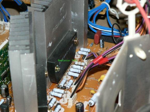

Hello I have a Panasonic PT53WX54J rear projection tv.I've had it since 2004 with no problems. Today it just shut itself off with no prior warning or picture distortion. I tried to power it back on and it clicks...but when it gets to the second click which usually turns on the picture nothing happens and the power LED blinks 3 times stops then blinks 3 times again and again. I took the back off and cleaned out the dust with compressed air and a vacuum.Tried again with no results. I read the article on the convergance amplifiers at chris palmers blogspot. Is there any other reason to get the 3 blinks or could I be certain that the convergance ic's are bad? Any other tests I can try?
** Another thing I noticed is the power LED does not glow as brightly when its trying to power up?
**Also some discoloration on resistor at R7013. Thank You.

Fixed with convergence ic's
Fixed with convergence ic's changed out the stk110's with the stk 150's works great.

I have the same problem, &
I have the same problem, & have been reading a lot of blogs; I noticed that you repl 110's with 150's.  Did you ever repl that funny looking resistor?  Where did you order your parts from?
