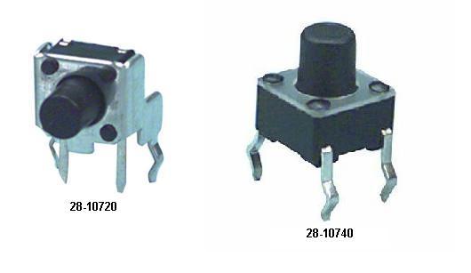

 Replace all the Tact Switchs
 Replace all the Tact Switchs  on the front Key panel board   mcmelectronics.com has them  just check to see what style your set has   28-10740 or 28-10720
