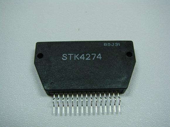

I need help in locating the convergence ic on my Hitachi  50UX22B   circuit board.  Hopefully this will take care of my problem.  seeing multiple color images

Your set has 3 IC'S  STK4274
Your set has 3 IC'S  STK4274  IK04=RED ,  IK05=GREEN  ,  IK06=BLUE
