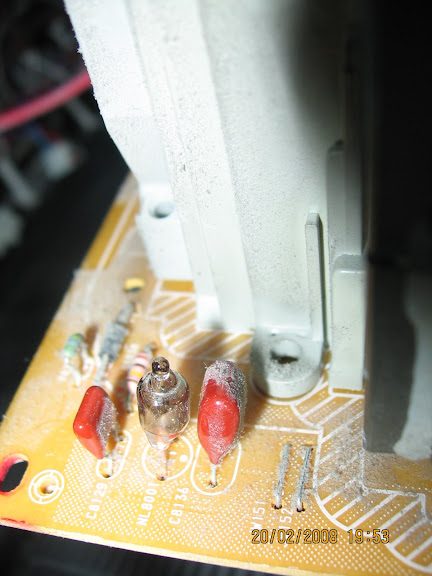

 I have a Sony KP-43HT20 with a convergence problem and just  received the replacement STK392-560 IC which I have not installed yet.  I checked all the pico fuses on the D board as well as on the G Board and they all checked OK, which I thought was unusuall since all other posts stated they will be opened.  This is the point where I'm questioning if the convergence IC are the main issue or something else.  I also noticed a part on the D board located all the way on the front left of the board which looks like a light bulb (nl8001), has a capacitor symbol and apears blackened as if it is burned.  Same part is on the very right board as well it too lokes burned.  I checked the continuity and it's an open.  So, I guess my question is what is that part and could this be part of the problem?
 Here is some pics:
 it's the component between two red caps.
Thank You!
Larry Dillon
No, it is suppose to check
No, it is suppose to check open my friend. That is a neon lamp and it is used as a spark gap. I have seen these short in the past, but if it measures no continuity, it is not your problem.
