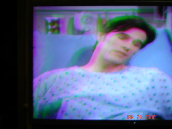

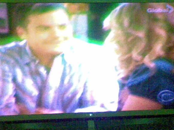

convergance problem with a twist i changed both ic's in this set but maybe thats not the problem the green screen is out of convergance alright as well it seems out of focus so it creates kind of a halo around any image am i looking in the wrong circuit thanks leroy

Well, i am not looking at the set, but here are some suggestions that may help. Dust on the lens inside the tv can cause a haze kind of effect, try cleaning the lenses. also try turning down the brightness that is the other knob on that same block see if that helps. If none of that works, try taking a picture of the problem and posting it here. Maybe after i see it i will have a better idea what is going on.
here are the photos of the green halo affect i have been trying to explain i hope this helps, leroy
