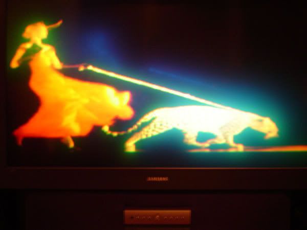

Here is one image that
Here is one image that details the ghosting pretty well (ironically a hitachi hi def commercial). This is standard definition broadcast stretched. It's not really quite that blurry, my digi cam is almost as old as this tv and doesn't do well into light sources, it can't focus on the image for some reason, unless I zoom out, but then you can't see some of the issues. I tried to take a picture of the small resolution lines, but again, the camera won't do it justice since it can't focus well on it...
Hope this helps explain my problem
HCL 4715 ghosting
Larry Dillon
That looks almost like a left
That looks almost like a left convergence issue to me?
