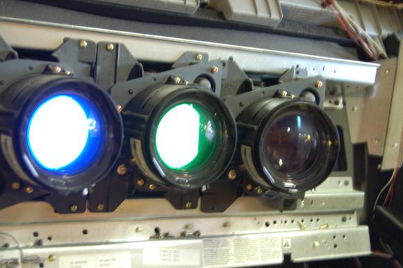

 SONY KP46WT500 CRT
 this is the problem when plug and try to turn on

Jmorozco
I change of posicion the crt
I change of posicion the crt and the crt green the light is seen but the crt red itself not nothing is seen.
I think that the crt red this damaged.

Jmorozco
I am sorry, I change the
I am sorry, I change the green board to red CRT but I not see the tube light and the green CRT I put the board from the red CRT I see the tube light up on in the green CRT.

Jmorozco
I swap all wires but I not
I swap all wires but I not see the lights up.
I think is the tube is bad!!
Jmorozco
Thank for all the help, I
Thank for all the help, I made the order for a new CRT.
