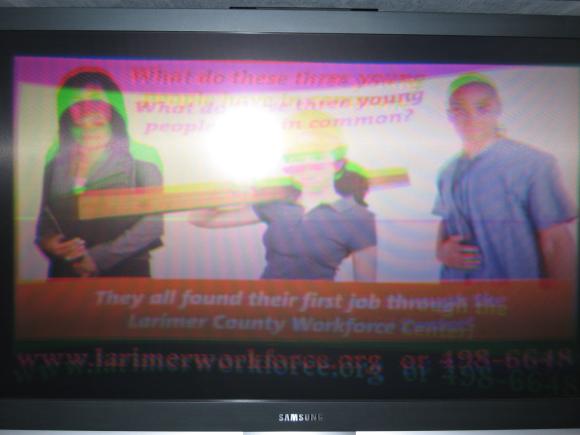

I have a Samsung HCN4727W (a 47" widescreen, HDTV-ready RPTV) bought in 2003, and the screen went bad 2 weeks ago. The screen looks like a lie-down hour glass. And the red and blue convergence didn’t work at all in convergence adjustment mode(Mute183) in service mode. The centers of red and blue test pattern are about 0.5 inch away. It looks like 3D movie without glasses. So, I changed 2 convergence correction IC(STK392-040) and checked 1.5ohm resisters with eyes not with DMM. Those resisters looked good. But, the problem didn’t disappear. Here is a screen capture.
Get the service manual. You will need that if you messed with the service mode. Also the manual will help you to see what voltages are suppose to be where on the convergence board. You will need to double check all of your solder connections. Also there should be a Plus and a minus 20 to 25 volts on each of the convergence IC. When the fuseable resistors go bad, most of the time there are no visable signs that they are bad so you will need an ohm metter to check them. If you go HERE and you will see the convergence IC STK392-040 Samsung part number 1201-001225 is $63.00. What STK did you use. If it was less then 20 bucks, your using whats known as a counterfit part. These IC's are not the same! They may be bad or unuseable in some applications. On that same parts list page I sent you, right underneath the STK IC, is the convergence amp boar part number BP95-00142p is $108.44. Thats is the complete convergence drive board. If these are available, I alwways recommend to replace the entire board. In your case, you will need to check and make sure the voltages are good. Good Luck and keep us informed of the progress of this repair on this TV.

I should have tested all fuses before I purchased 2 convergence ICs. It was a PICO Littelfuse. There are two PICO fuses in the convergence board and one of them is bad. It is LF3 1/2A. But, I couldn't identify which series it is. Here is a picture.
Any .5 amp pico fuse should work for you. A service center should have one for you.

If you have a blown fuse, you have a bad convergence ic, just changing the fuse will not work.
