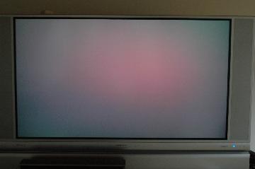

I have a 50 " LCD TV modle 50V500. It has what looks like a cloud in the middle of screen on all channels.It is a Hitachi. Can someone tell me what causes this , and how to fix it.It is almost two years old.I have put a new lamp in it, and still have the problem.

Let me guess. 12-18 months
Let me guess. 12-18 months old, a red blob or haze started in the middle of the screen, visible on unused inputs or dark screens, and has gotten progressively worse? Common problem. Light engine failure. Hope you have an extended warranty. Sorry. Mine is the same way. Going to make a call adn see what we can do with it.

Looks like this?
Looks like this?

Yes! this is the way it looks
Yes! this is the way it looks. does it cost much to fix this problem?

See posting for Hitachi lcd by tinoushrr and my reponse. I have the same problem (blue haze spreading from middle of screen) after replacing with new OE lamp. It looks like others do as well.
  I am calling Hitachi support and local tech but if this is a common problem we should all let Hitachi know. My 2 year extended warranty ran out earlier this year and I will not be a happy camper  after spending all this money on the set, if Hitachi doesn't offer some redress.
